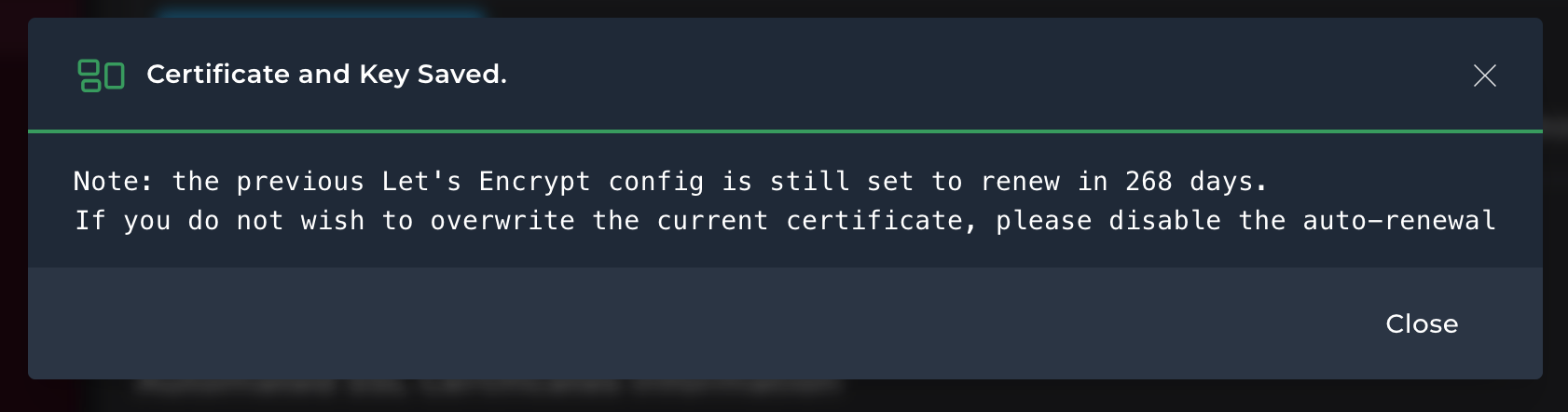

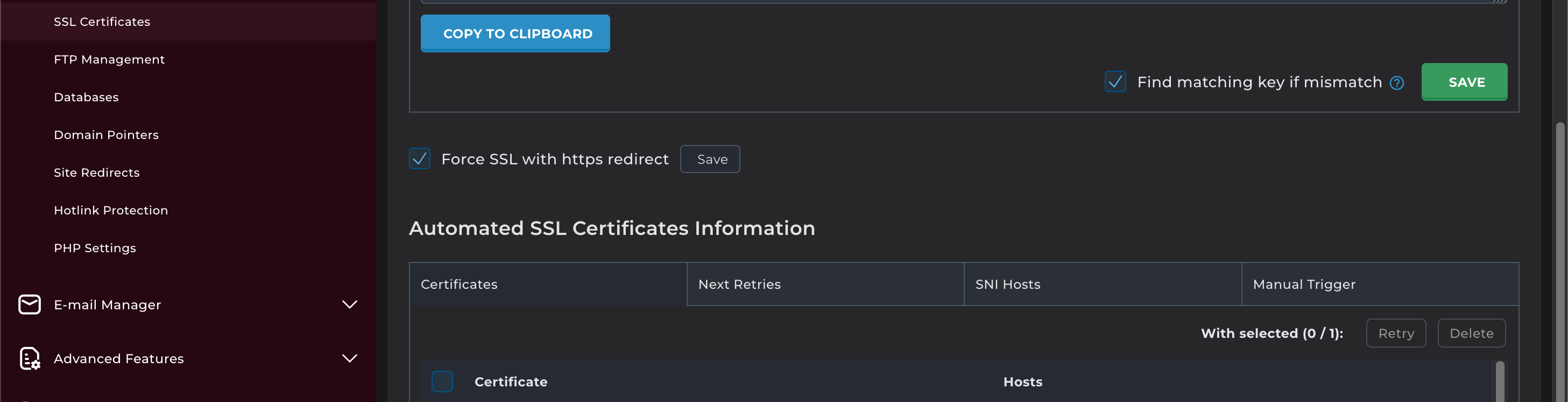

Also running OLS here, and we hit this in a niche case - EV SSL installed on several accounts (multi-SAN), but each vhost involved with the EV was serving the hostname's cert instead. Tried rewrite_confs and building everything again, no joy.
In the end, just had to login to each EV-related account in DA, go to SSL Certificates, and click Save for the current cert. Sorted!
