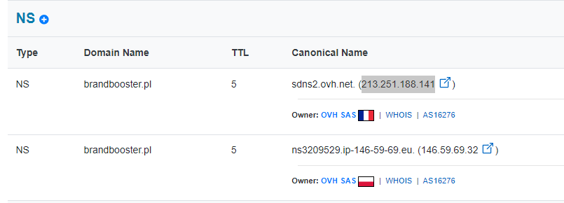

I have still troubles with domains which has sdns2.ovh.net as secondary NS server.... and only if I want SSL WILDCARD, without wildcard it's working fine.... why?! any ideas why only with ovh?
It have to be something with SDNS2.OVH.NET but I don't know what.... it's 4-5 different servers and every time the same problem with that stupid DNS and WIldcard....
TTL is 5....

It looks like maybe 5 minutes is not much for local domain in directadmin? Even if TTL is only 5.... maybe it should be 10 minutes?
I am not certain how your DNS is setup , is your DNS managed by OVH ?, there seems be some sync problems
I have domain on some domain provider (not ovh) - I wrote there that NS servers and I can manage this domain on my server in DIrectadmin.. that's all.... normal simple thing :)

allow-transfer { 213.251.188.141; };
I don't know what you do, but only the sdns2.ovh.net is allowed to transfer records.
For wildcard, you either need your own nameservers, or use LEGO or create some solution yourself so the records get copied fast enough to your external nameservers.
DA will not copy records automatically to your sdns2.ovh.net server, if that even allows you to change records, because it's from OVH. So i think there is your issue.
