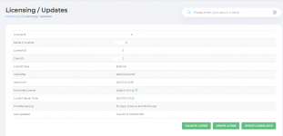

Currently it says the expiry is in 30 days 23 hours xx minutes...
I have just manually update it again. When I wrote this thread, I have just updated the license and it has expired again. So sometimes it takes days, sometimes it only takes hours before it will expire again.
Looks good to me. If it again expires soon you can still best contact sales or support for this issue.
