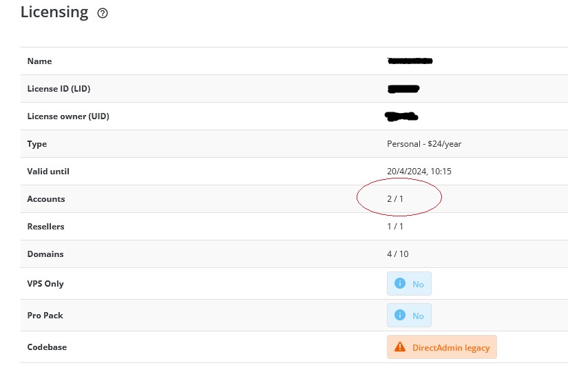

Hello, I have a server with a personal license (1 account 10 domains) and when I try to access MySQL Management I get this error:
License limits exceeded​
2 of 1 accounts currently exist.
https://help.directadmin.com/item.php?id=2139

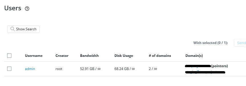

The server has only one account (admin) and 2 sites (the production site and a copy for staging) as you can see in the enclosed picture 107
but in the licensing panel it shows 2 account (see enclosed picture 107)

The server was fresh installed on april 2023 with this panel and no licenses where changed since then.
Where is this "ghost" account ?
Does anyone have some suggestions for resolving this?

Might be worth checking /usr/local/directadmin/data/users (i.e. ll /usr/local/directadmin/data/users) to see if there's any users other than admin in there.
Thanks for the suggestion but there is only one user:
[root@server ~]# ls -lah /usr/local/directadmin/data/users
total 12K
drwx--x--x.  3 diradmin diradmin 4.0K Apr 18  2023 .
drwx--x--x. 10 diradmin diradmin 4.0K Oct 19 19:16 ..
drwx--x--x.  8 diradmin diradmin 4.0K Oct 19 13:22 admin

I found the solution!
The problem was generated by a backup unpacked in the root's home.
I deleted the "domains" folder and everithing is ok now.
