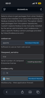

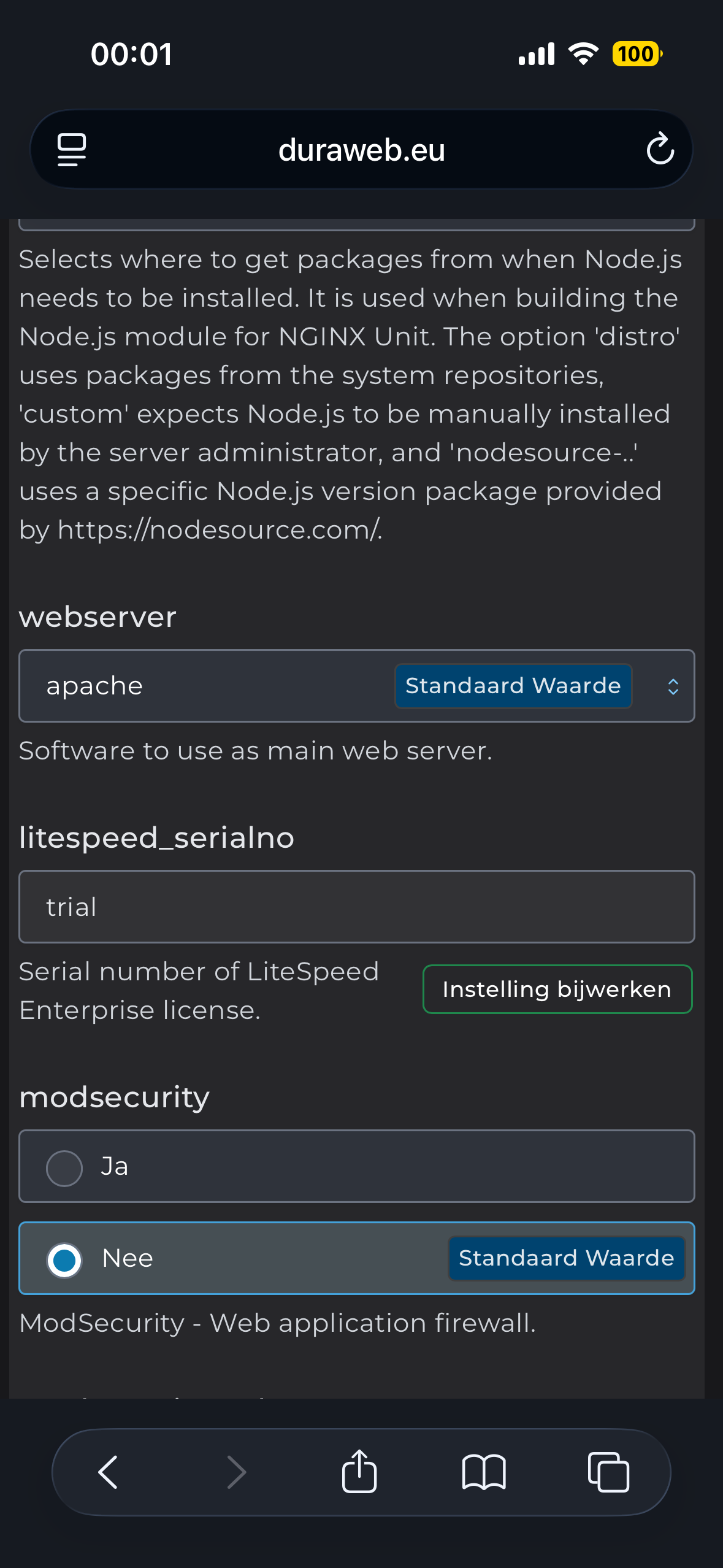

Well i followed the minimal install recommended by directadmin of my almalinux 9, and the rest with custombuild inside directadmin. There is nothing that i installed myself than just that, all quire straightforward. And i use always apache instead of nginx,
Also as you can see in the screenshot of custombuild at webserver apache.
Then it is unclear why you have that "httpd" file present. I recommend to move out that "httpd" file from "/etc/logrotate.d/" directory and then check if you can start/restart "logrotate" service.
