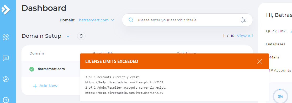

what is this message? Why am i getting this after i bought the license after the trail period?
Mail issue. Mx Records required. Also is the NS provided in the DNS records can be entered in the domain?Untitled.png

Personal License, meaning 1User (And) 10Domains ( count by All User )
Admin or Reseller or Normal User = 1User
Domain will count all User > 10,
mean it's doesn't count per User
Richard G
Jul 6, 2008
6,484
Maastricht
Correct, it counts per account. And there may only exist 1 account with personal license, which is admin. So admin can have 10 domains.
Like Zhenyapan says, he needs to remove both accounts mentioned.

But then this sounds ridiculous. Coz there is understandably only one Admin and the other two are actually below it. I can remove the reseller account that's... still okay but the User i would need for the developer's to access a separate panel other than the DA root access. Sounds absolutely insane and unfair...
That's your opinion. The personal license is very clear about it. It's a personal license, 1 person, not more persons.
You could create separate FTP accounts for developpers with seperate access for example, that is possible.
Nothing unfair about it, there is a reason the price is that low for the personal license.
