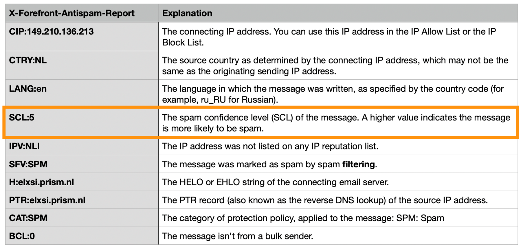

To go a little more in depth here:
  1. This IP address is quite high in volume, for a DirectAdmin server
  2. This IP is already active for over 10 years
  3. This IP isn't on any blocklist, also verified directly when I try to delist on https://sender.office.com
  4. This IP is already in our SNDS for years as well know, status normal
  5. This IP doesn't have any recent JMPR reports
  6. This IP email reputations is listed as Good on https://talosintelligence.com
  7. The domain has a valid SPF record
  8. The domains DKIM is setup and works as expected (10/10 score on http://www.mail-tester.com)
So like @mxroute writes, it's quite frustrating.
From a sample email to a Microsoft 365 hosted email account I did get some more clues in the headers. Spam Confidence Level 5 means it will be filtered as spam, also see: https://docs.microsoft.com/en-gb/mi...ty/spam-confidence-levels?view=o365-worldwide
The headers with some explanation directly next to it:
