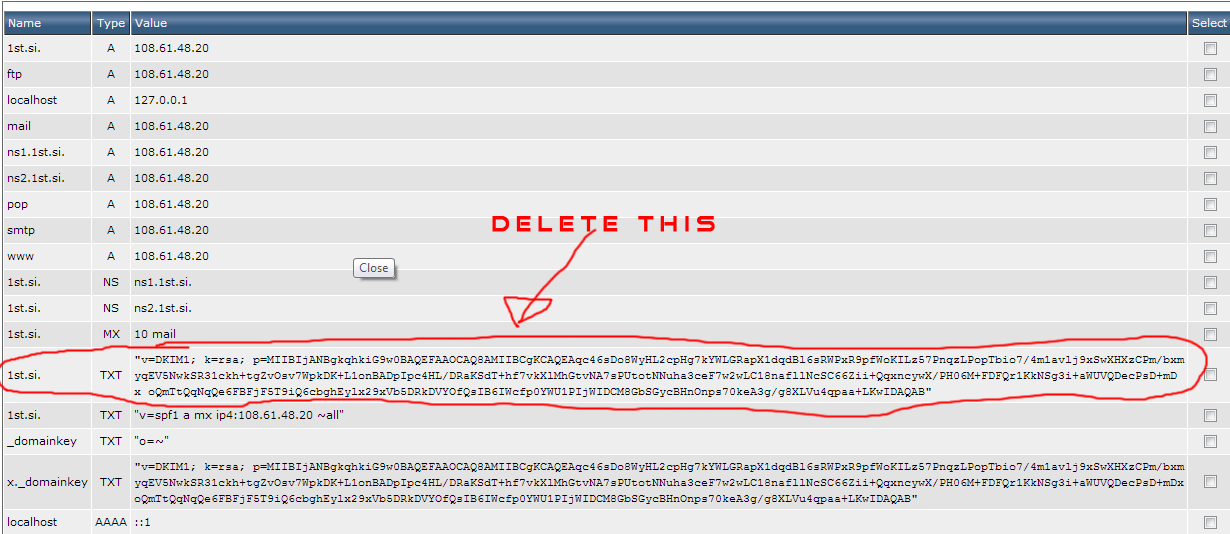

However I notice you have two DKIM keys, that is not correct unless you know why you did it, and have a good reason for it? If not, look at my screenshot and delete the DKIM key I have marked in red.
Thanks, I've deleted what you marked..
