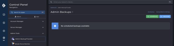

If on the server where the account is, I go to Admin Backup/Transfer, I don't see the same as in the examples.

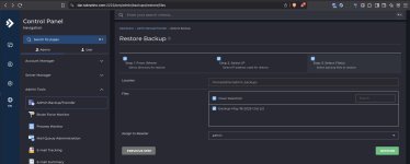

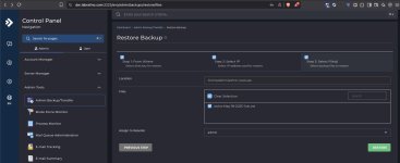

If I move that backup to the destination server and try to use it in Admin Backup/Transfer Restore Backup, either with its original name or renaming it with the username, I get the error:
backup-May-18-2025-1 is not a valid username
aicha-May-18-2025-1 is not a valid username

The backup present in the 3rd screenshot is a user backup, not an admin backup. The backup name in the 4th screenshot is unkown to me.

In original server as admin i can backup one user evo/admin/backups/scheduled
If click on Site Backup got to /evo/user/domains/add-domain
if search for Backup get
If go to user for create backup, the backup is backup in original post. Not usable in destination post.
This With admin backup/restore you can select a single user to backup. not exists on my original server.

Click the green Schedule button on Admin Backups and it will walk you through the process. I have done this many times.
