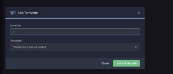

I see now, in user level, Nginx URL Writes... evo/user/nginx-templates
Best regards.

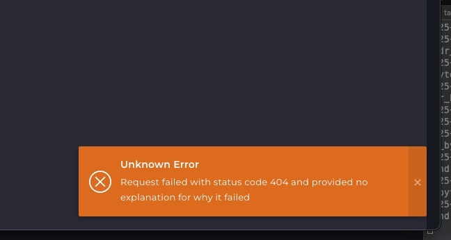

Ops.
I don't see error..
I have tired with / and /home/USER/domains/DOMAIN.tld/public_html
All cases, get same error with nginx server only.

Hello and Thank you so much for your help @smtalk
As a general rule, I always check the logs in the shell.
In this case, since I wasn't even sure which log something like this would go in, I got an error telling me right away that there was no information to give me, so I activated tail -f for all logs, with 0 results that could tell me anything.
Bash:
2025/05/25 08:36:19 [error] 288558#0: *6611 "/home/castris/domains/castris.com/private_html/blog/index.php" is not found (2: No such file or directory), client: 91.121.226.50, server: castris.com, request: "GET /blog/ HTTP/2.0", host: "castris.com", referrer: "https://castris.com/"
2025/05/25 08:37:57 [error] 288559#0: *6624 "/home/castris/domains/castris.com/private_html/blog/index.php" is not found (2: No such file or directory), client: 91.121.226.50, server: castris.com, request: "GET /blog/ HTTP/2.0", host: "castris.com", referrer: "https://castris.com/"
That's all the log says.
And the worst part is that after giving me the error, it shows me that the job was done.
I've tried absolute, relative, etc. paths. It's good that this was also well documented. At least I wasn't able to see it in the documentation.
Unknow Error
Request failed with status code 404 and provided no explanation for why it failed
Also, if I go to the nginx configuration for the vhost, I see its configuration, although it's not correct, which is why the problem occurs.
