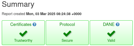

The scripts worked and I got all green on https://ssl-tools.net/mailservers/
