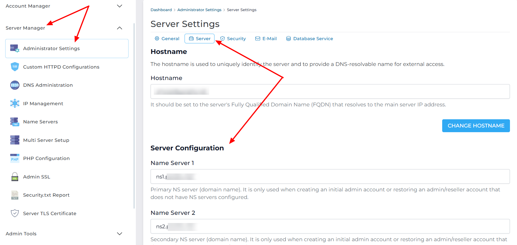

Update nameservers in DirectAdmin: Dashboard -> Administrator Settings -> Server Settings

What i'm doing wrong?
Nothing, but probably you changed the hostname after installing directadmin or something went wrong.
You can change as @zEitEr shown above. However, most likely since the da.direct is still mentioned in the nameservers, I wonder if things went correct and everything is present.
Maybe it's good to check if your hostname SSL certificate is pointing to the correct hostname, to see if maybe some other things need to be adjusted too.

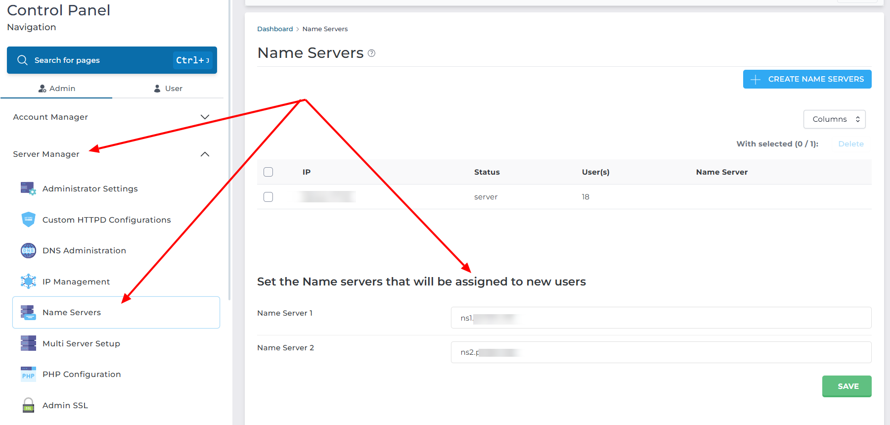

You entered the correct nameservers both on server settings (first) and then Name Servers (second)?
Did it create the nameserver entry's (A and NS records) in your nameserver domain?

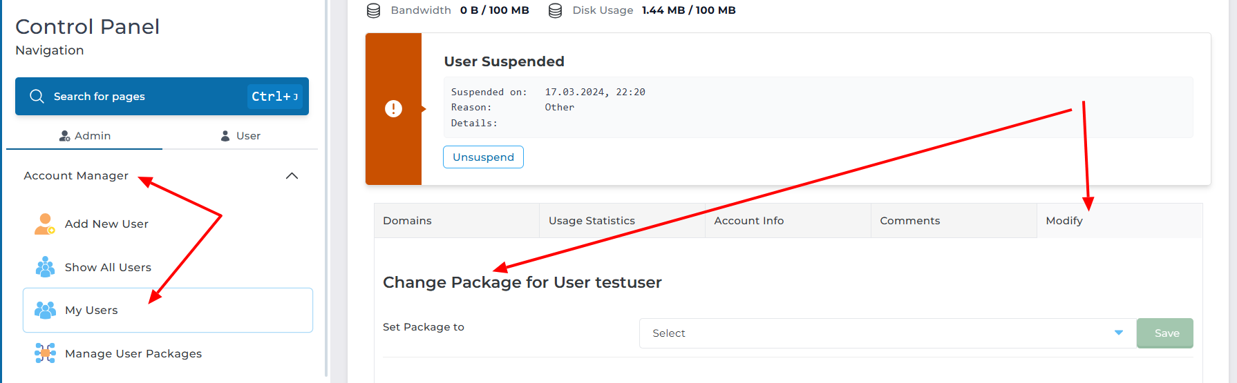

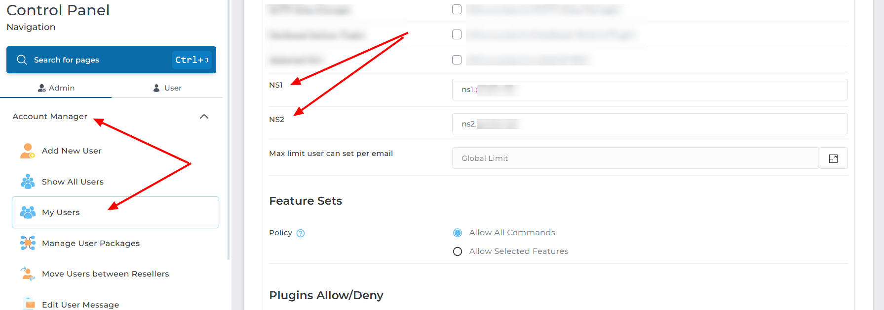

Users once created have a fixed set of nameservers in their settings/packages:
scroll down to NS1 and NS2
You removed a domain, but not a user. That's the reason.
