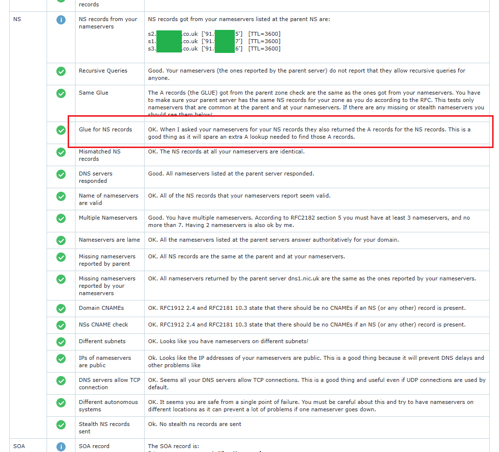

Couple of months ago I moved my main server to a new dedicated server running Debian 11.
I always have had my own nameservers (three servers, different places) but since the move intodns reports an informational message I never had before.
intoDNS: buggedbrain.com - check DNS server and mail server health
intoDNS: Checking health and configurtion of DNS server and mail server for domainbuggedbrain.com.
INFO: GLUE was not sent when I asked your nameservers for your NS records.This is ok but you should know that in this case an extra A record lookup is required in order to get the IPs of your NS records. The nameservers without glue are:
78.46.78.132
You can fix this for example by adding A records to your nameservers for the zones listed above.
I understand this is an informational message, and an extra A lookup isn't that expensive these days, but we all want to deliver a perfect service.
I suppose into dns does a dig query to the nameservers to find out everything it displays? I discovered the Debian 11 servers has less info in the additional section of the response.
