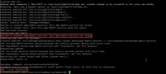

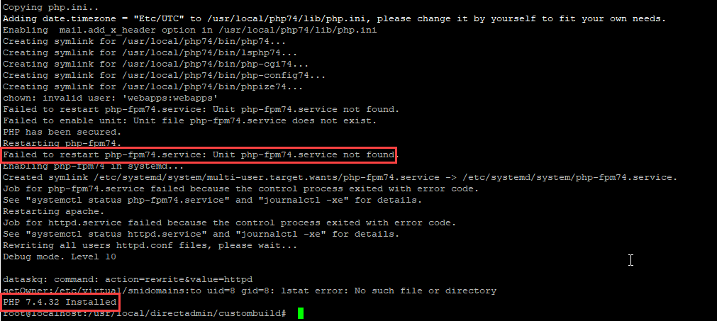

Sir, PHP 7.4.32 Installed but It is also showing me Errors.

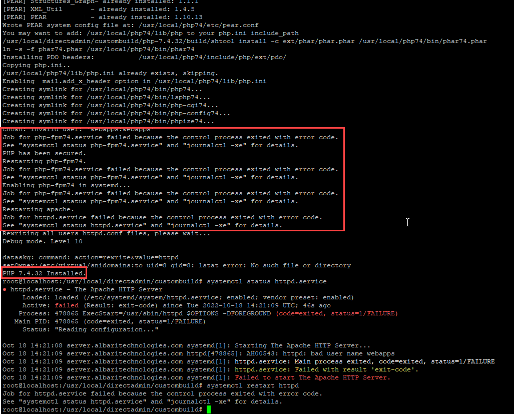

Sir, I have run "systemctl restart httpd" Command it is giving me below output:

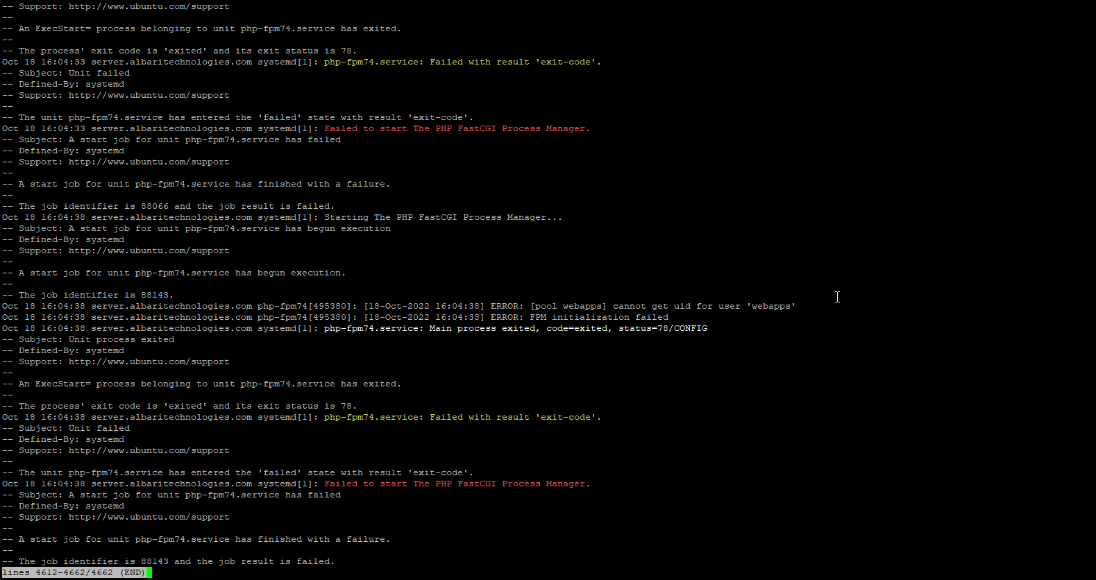

Sir, I have run "systemctl status httpd.service" Command it is giving me below output:
Seems php-fpm can not get the uid for the user "webapps", that is odd.
