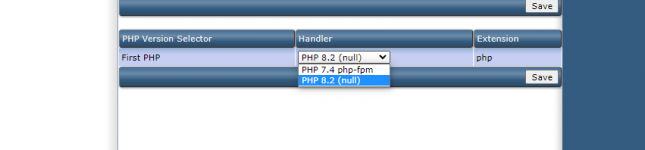

In the attachement you can see how it looks like now. The 7.4 works fine.
But the 8.2 doesn't work. And I saw something strange. In the other attachment you see the php handler. After php 7.4 I see php-fpm
But after the 8.2 I don't see the mode. It says (null)
So I have the idea the installation didn't go the way it should be.

If i'm not mistaken, you "enabled" the option 8.2 but did not build/install the 8.2
I think you need to run:
./build php n

I don't think that is the issue here. The PHP version selector as in the screenshot also works in Enhanced skin and the screenshot is showing the enhanced skin.
Also he compiled via SSH, so he did not use custombuild plugin. Or do you mean the left side screenshot?

I just did the commands like you wrote. And here I get the messages. What could this be?
Package 1:pkgconfig-0.27.1-4.el7.x86_64 already installed and latest version
Package 1:openssl-devel-1.0.2k-26.el7_9.x86_64 already installed and latest vers ion
Package systemd-devel-219-78.el7_9.7.x86_64 already installed and latest version
Package krb5-devel-1.15.1-55.el7_9.x86_64 already installed and latest version
Package libcurl-devel-7.29.0-59.el7_9.1.x86_64 already installed and latest vers ion
Package 2:libpng-devel-1.5.13-8.el7.x86_64 already installed and latest version
Package freetype-devel-2.8-14.el7_9.1.x86_64 already installed and latest versio n
Package libwebp-devel-0.3.0-11.el7.x86_64 already installed and latest version
Package libjpeg-turbo-devel-1.2.90-8.el7.x86_64 already installed and latest ver sion
Package libxslt-devel-1.1.28-6.el7.x86_64 already installed and latest version
Package libsodium-devel-1.0.18-1.el7.x86_64 already installed and latest version
Package libicu-devel-50.2-4.el7_7.x86_64 already installed and latest version
Package sqlite-devel-3.7.17-8.el7_7.1.x86_64 already installed and latest versio n
Package oniguruma-devel-6.8.2-2.el7.x86_64 already installed and latest version
download_with_cache: using cached '/usr/local/directadmin/custombuild/cache/php- 8.2.8.tar.gz' file
Extracting ...
Done.
Configuring php-8.2.8...
Patching php-fpm for per-user process grouping
patching file sapi/fpm/fpm/fpm_children.c
Hunk #1 succeeded at 454 (offset 23 lines).
Patching php-fpm to not fail on startup if User quota maxed out on socket chown
patching file sapi/fpm/fpm/fpm_unix.c
Hunk #1 succeeded at 299 (offset 64 lines).
grep: : No such file or directory
Can't open : No such file or directory.
./build: line 9337: : command not found
*** There was an error while trying to configure php. Check the configure file

Why? He is running the commands from SSH not from the plugin, so that error has nothing to do with using the Enhanced skin, we use the enhanced skin too.
Good question. Maybe you can best update DA first so the Custombuild plugin GUI will be removed from the Enhanced skin too and maybe there is a fix for the build of the newer php versions.

but for @stof problem. That error is somehow missing some configuration files.
