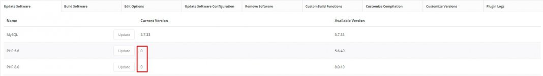

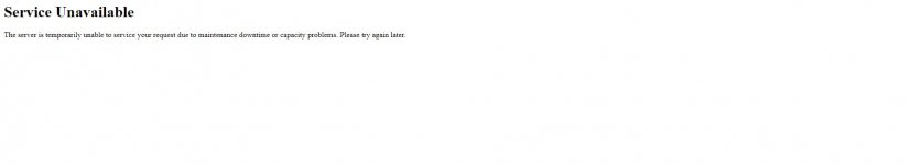

Hello colleagues,
so I am very new with Direct Admin and maybe someone could advise what to do or where to search for problem?
OS: Debian 10
DA: latest version
1) Problem with updating PHP versions because it shows 0 where is current version (prnt scrn attached).
2) Problem with PHPmyAdmin can't launch it (prnt scrn attached).
Logs doesn't show anything useful, only when trying to update PHP 5.6 I get error below:
configure: error: Please reinstall the libcurl distribution - easy.h should be in <curl-dir>/include/curl/
Any help would be useful, p.s. websites working fine, only can't launch phpmyadmin and always get this error after fresh DA install.

Unfortunately I took crappy notes when I installed DA and I cannot remember if it asked me during the install process what versions of PHP I wanted to load. I can tell you that although I am running PHP 8.0 on the web servers, phpmyadmin uses PHP 7.4. Again, I cannot remember if I installed it (because up until like 3 days ago I was using 7.4). Maybe someone here knows if you need to install PHP 7.4 for phpmyadmin to work.
Thanks for answer... Already changed 4 DA servers to other system...
