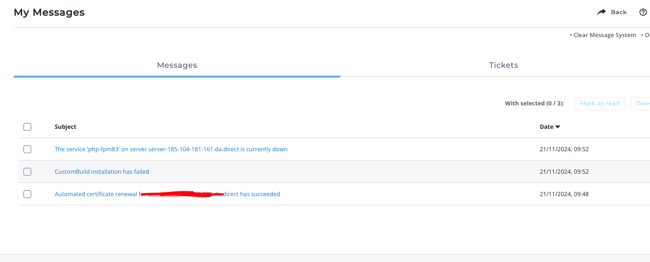

Hello ,
I believe the installation has finished , please review the screenshot attached .

On the screenshot is nothing about a finished installation. So I dont think its finished. Or it was, but not successfully , and was maybe somehow interrupted by your interactions, now missing a successfully (working) CB install. You can now a) start from fresh, take your time and wait for a finished message, and have a clean system. Or .. b) try to repair CB, but it is unsure if CB is the only problem. If the installation was not finished (and it looks so) then you may encounter more problems after CB repair, or any mysterious error in the future.

Now it works , the only thing different i created a new server with Debian 12 instead of Ubuntu 24.04 , dunno why , as I did the same things as before .
Nevertheless , thanks for your help .
You're probably on a license from your vps/server provider then or having another kind of legacy license which do not support newer operating systems anymore.
Last OS on legacy license for Debian and relatives are Debian 12 and Ubuntu 20 so that might explain the issue.
