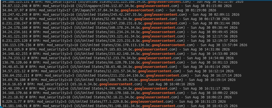

Preventing malicious traffic from bc.googleusercontent.com
After my last post I wrote a cron script to retrieve and block googleusercontent ip's with CSF/LFD.
Add in /etc/csf/csf.blocklists (or use the CSF web ui)
GOOGLECLOUD|86400|0|https://domain.com/blocklists/bcgoogle-cloud_ips.txt
Use a domain you own or have access to. (If the blocklist isn't loaded afterwards by CSF, then check folder and file permissions)

Anecdotally, GCP abuse seems to have died down a bit on my side. I used to see 10+ notifications from CSF a day from the GCP network and I don't recall the last one I saw.
Did they finally get their house in order?
I ended up using a ModSecurity rule for this, because there has been an uptick of bad GCP traffic again. I can't block at the firewall level because of Cloudflare/etc. use.
It appears to be working reasonably well. It's server wide, monitoring for bursts and then rate-limiting. Unsure if I am going to block outright, but need to make sure I get it right with Google Crawler since it appears they might use some ranges from GCP (as dumb as that sounds).
I switched from CSF to ModSecurity to block incoming traffic from Google Cloud and Amazon AWS.
