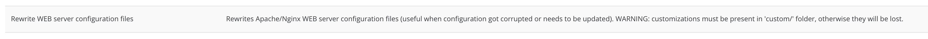

also, could it be you are running a prerelease version of DA?
try running
./build update
./build rewrite_confs

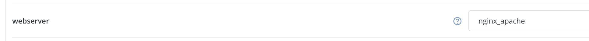

./build update
./build set webserver nginx_apache
./build nginx_apache
