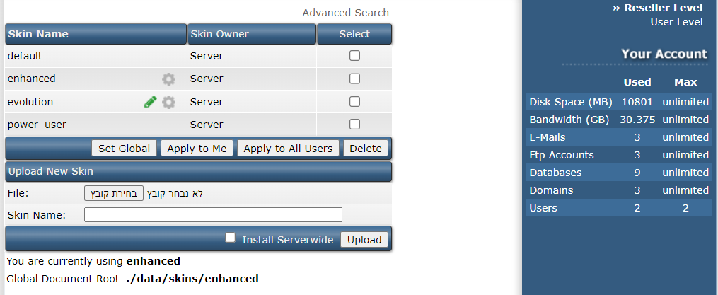

Regarding option 1:
I'm trying so switch but the only thing that is changing is the "login" screen, all the rest remain tha same :\
Why is that?
I'm swtiching through "Reseller Level -> Skin Manager"
UPDATE:
1) I got it, I press on "Apply to All Users" (Which doesn't work, I don't know why) instead of "Apply to Me" (Which is working)
2) In "Evolution" skin, I don't know why, but it shows me two option "CustomBuild" and "CustomBuild 2"
"CustomBuild 2" shows an error, "CustomBuild" is the one that is working.

Did you logged in as admin, then clicked Reseller level, then clicked Skin Manager? Then select Evolution and clicked, 'apply to me'?
Ok, I see you fixed it already, nice!
It should switch right after that. Then you still have a few skin layout options. You can choose standard, sidebar, Refreshed etc. I personally had the best experience with Refreshed and then pinned the navigation. But this is personal for every other user, see what fits best.
