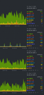

The issue with Rclone using BlackBlaze in my VPS is that It seems to be using to much resources somewhere in the moving process that makes some websites to be down (timeout response) for about 5 min.
I tried looking into logs with --DEBUG and -vv flags and everything seems fine.
Then I looked to NETDATA and saw something strange. Maybe is not real.
But Rclone seems to be using only one cpu for network process (sortirq) and not all the rest of CPUs (6 cores).
So I asked Datacenter and they said it was a software issue because it was only using one cpu to transfer data out of my server.
I do not know why a 150MB transfer out makes websites down (30% CPU usage).

Now some NETDATA screenshots:

I do not know why softirq is 100% load over one of the CPUs when transfering out.
Maybe some KVM issue? config? setting?

Yes, I know that but my VPS is a KVM virtualization with dedicated resources.
I do not event know where to check network drivers.
Datacenter told me it was a software issue. But I not quite shure.
