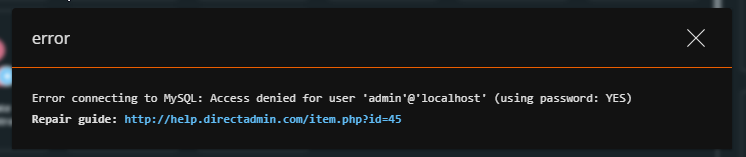

But when on DA dashboard at admin and user level, i find on the navigation filter for mysql and get empty results
And on the top search box i found mysql management but when click get this error
So if you are as admin on user level and click mysql management (first row I believe) then you don't get the option to create a database?
Very odd indeed.
Maybe OS reload is the best option.

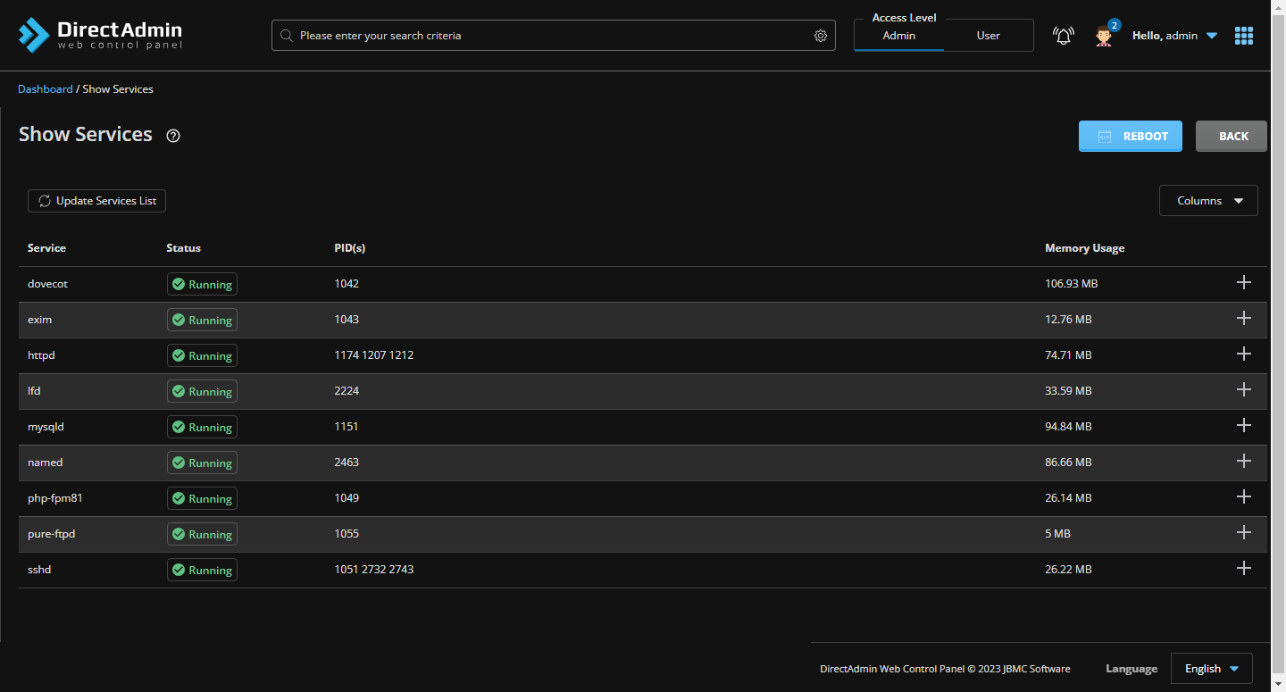

Yeah, was fast, server have nvme
Look, this is what is active by now
I already set the hostname and its responding to pings
