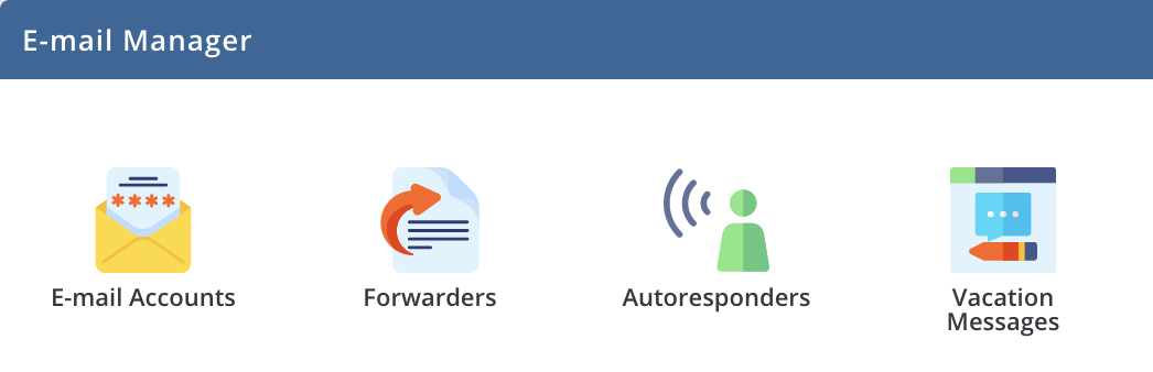

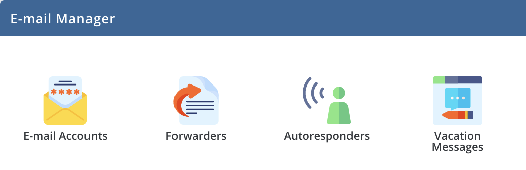

i enabled in custombuild pigeonhole and ran the build all command and went to sleep it took a long time to do the all command and when i waked up its listed up here that it shows up but doesnt work
You don't have to run build all. Although its good to do it sometimes. Also saying it doesn't work doesn't help me help you..
in Roundcube do you see filters?
./build set pigeonhole yes
./build dovecot
./build dovecot_conf
./build roundcube
This is what i have but the filters dont work theyre not getting a forward to the email i specified
