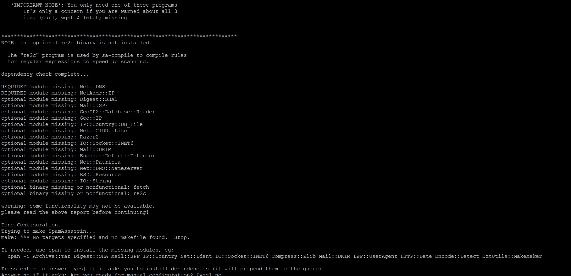

If i do:
./build set spamd spamassassin
./build spamassassin
then message changed spamd from spamassssin to spamassssin
but with build a lot of error not finding dependencies ( to much i have only printscreens saved )

now i get
