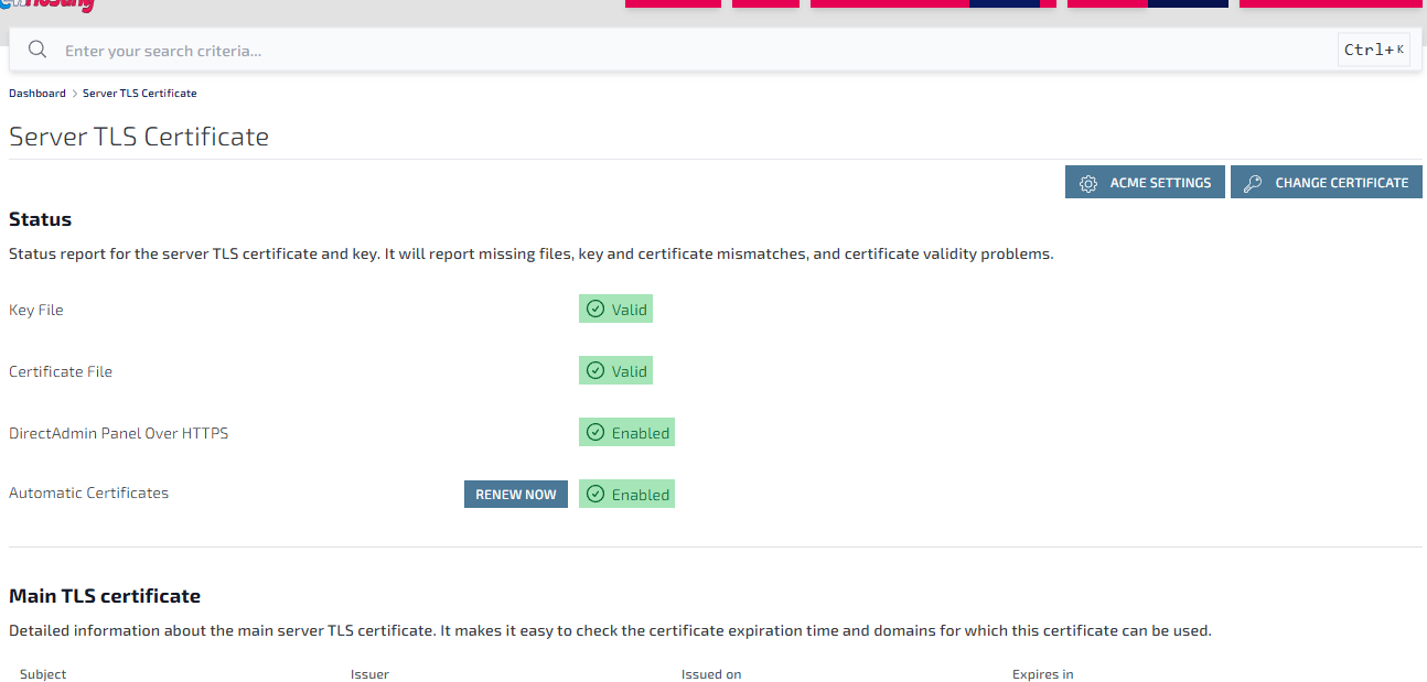

Hi, I'm a complete newbie in Directadmin (I come from a cPanel backgroud). How can I fix the Server TLS certificate?
I'm getting this error: "x509: certificate is valid for localhost, not servidor.dametuip.com".
Of course, the certificate shows as "not trusted".
I'd like to use a free (letsencrypt or similar) certificate.
Thanks!
Run as user:
Bash:
/usr/local/directadmin/scripts/hostname.sh servidor.dametuip.com
/usr/local/directadmin/scripts/letsencrypt.sh server_cert servidor.dametuip.com
replace servidor.dametuip.com with a real hostname, in case you masked it here.
navigate to:
https://[your-domain]:2222/evo/admin/server-tls
Options are here.
Thanks! It's working now. The correct second line should be:

Normally no need to replace, just use /usr/local/directadmin/scripts/letsencrypt.sh server_cert which is the correct command according to the docs and the script will autodetect the correct hostname which is provided to DA. Will prevent typo's too.
