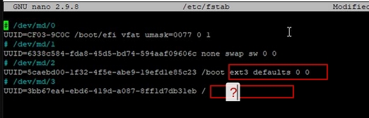

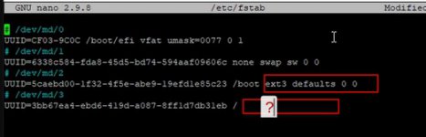

Now i edit the file /etc/fstab
And put a # at the arrows:
Now during reboot i get "Failed to mount /home2"

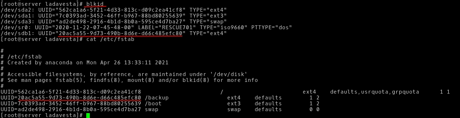

very strange dev-address, remove this string, boot normally without it. check correct UUID and mount it by UUID.
you can check UUID with "blkid" command
like on screen
and why mount point cropped? where filesystem and mount options? for last line.
