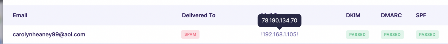

Attached is the emailable website's delivery report. The email is put in the spam folder because the sender IP, (not MTA IP), is on the blacklist.
The server IP is not on the blacklist, and all DKIM, DMARC, and SPF settings are correctly done.
I figured out this problem after using this email deliverability report.
The IP on the attachment is not the server IP, it is the user's IP given by ISP and it caused the email to be put in spam because the IP was blacklisted.
The email address in the attachment is given by the emailable website to test if the email is in spam or inbox.
Mail goes into spam on AOL too for the same reason.
