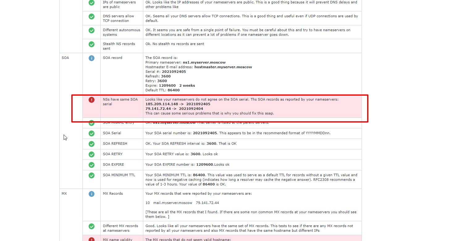

Hi I bought two licenses for my virtual machines to create a multi server. The problem is that when I connect to server b to transfer dns it does not do so. I have used the echo command via ssh to pass the dns this does not work either. I tried placing the dns entries for server b manually. But this starts not matching the SOA Serial #: records when the update command systemctl restart named SOA Serial #: are changed on server b for all records. I did an automatic directadmin installation. In the ip manager I have two ip internal and external. Could this be the reason?

Okay, I tried creating servers with a public subnet. Also tried to create servers with private subnet working via floating ip. The thing is that when you add dns records to server A, they are not synchronized with server B.
Although domain validation works on both servers. The problem is that even if I add dns record manually on the server B, then when you edit the record on the server A starts changing SOA record it is clearly visible in the screenshot which I left above!
Is there a solution or am I something I do not understand, maybe there is a manual from a third party auto to figure out how to properly configure the multi server. And also the problem is not in Nat network.

The most important thing, when you did the multi server setup. Did you run the synchronisation command on both servers?
echo "action=rewrite&value=named" >> /usr/local/directadmin/data/task.queue
This should also take care of the SOA record. I have setup this multiple times and never had issues.
It's normal that if you change a record on server A, the SOA record changes, after that, the change should be given to Server B and update SOA record there too.

Yes, I followed these sequential steps, and it all did not work exactly. I already mentioned I was able to do this with a trial license, I executed the sync command and all DNS records appeared on server B. But with purchased licenses, this does not work.
The most interesting thing is that it can check domains from the server. But cannot transfer records?
??? That is very odd indeed. Normally trial or final license should make no difference at all. As far as I know (if I'm not mistaken) that's only change by license number, not binaries.
I think in this case, if nothing can be found in named logs and DA logs and all ownership and permissions are good, you might best send in a ticket for this.
I'm very curious now as to what is causing this.
P.s. you also checked the test on the multi server setup page? That give all OK too I guess.
