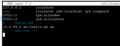

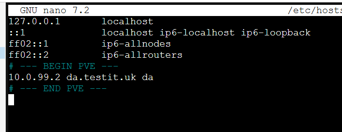

I bought a dell poweredge last year and use it for test builds of allsorts. I know when I setup a vm with DA on it, the /etc/hosts file will have something like:
But the ip address 10.0.99.2 is made static in my router, i'll make sure my public IP is set as the A record on 3 DNS servers, and i'll set the DMZ up so all incoming traffic just comes to this server when i'm testing. My point here is it looks like a locally hosted machine for OP, so I suspect ports being an issue not being opened and forwarded correctly? I did an nmap on his IP earlier and ports were closed. That's my thoughts anyway.
I use Ubuntu 24.04 Pro , not Alma or Rocky.
