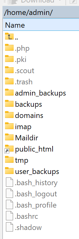

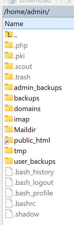

Also check for the existance of a /home/user/.spamassassin directory (where "user" is the correct accountname), containing a user_prefs file.

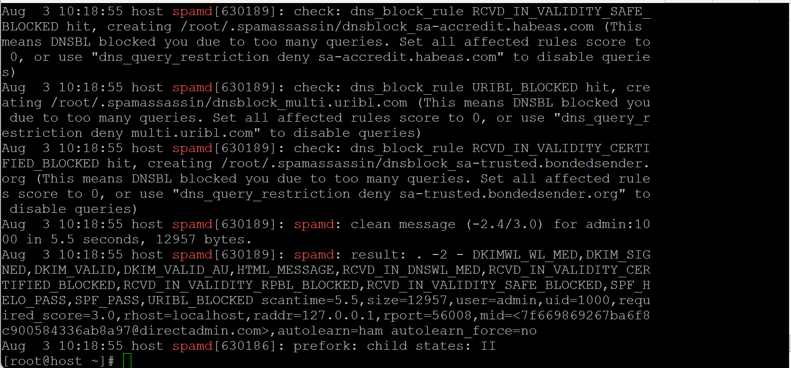

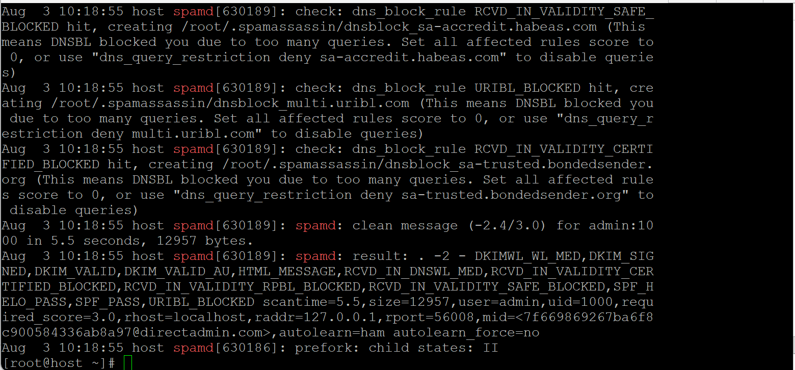

Run this via terminal without quotes:
"grep spamd /var/log/maillog"
If it says file not found, run:
"grep spamd /var/log/mail.log"
If it returns a bunch of lines and they're not errors, SpamAssassin is working. If it returns nothing, then we know it really isn't. It's just too plausible for it to be running but you not notice because default SpamAssassin sucks.

This means it's working and we're going back to what I thought it was originally. It's not working as well as you want it to. That's pretty much everyone's story with a default SpamAssassin installation. It doesn't catch much spam these days.

If I run with maillog instead of mail.log I get this:
