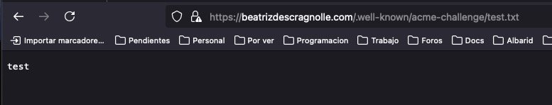

Hi.
Sceneario​
Troubleshooting Let's Encrypt Errors
cat /usr/local/directadmin/conf/directadmin.conf | grep letsencrypt=1
letsencrypt=1
cat /etc/httpd/conf/extra/httpd-alias.conf
Alias /.well-known/acme-challenge /var/www/html/.well-known/acme-challenge
da build rewrite_confs
echo "test" >> /var/www/html/.well-known/acme-challenge/test.txt
curl -I -L -k -X GET http://beatrizdescragnolle.com/.well-known/acme-challenge/test.txt
HTTP/1.1 301 Moved Permanently
Server: nginx
Date: Sat, 14 Dec 2024 14:38:14 GMT
Content-Type: text/html
Content-Length: 162
Connection: keep-alive
Location: https://beatrizdescragnolle.com/.well-known/acme-challenge/test.txt
HTTP/2 200
server: nginx
date: Sat, 14 Dec 2024 14:38:14 GMT
content-type: text/plain
content-length: 5
last-modified: Sat, 14 Dec 2024 14:36:03 GMT
etag: "5-6293bddf08fbc"
accept-ranges: bytes
vary: User-Agent
Also tries manual forcing.
