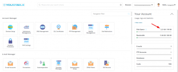

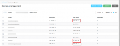

I have noticed that the statics shown on the main dashboard of the user is wrong.
For example, there is a user who is having 8 domains and approx disk usage size is 23GB but on the main dashboard, it's showing only 2GB.
I am attaching the screenshot for the same.
Is there any way to sync the actual data?

Make sure tally cron is running in Direct Admin, it updates these stats.
Thanks for your reply.
Tally cron is already running but then also, it's showing wrong stats.
On further checking, I found that in disk space it's showing the size of lscache directory but for the correct stats it should show the size of domain directory or myfiles directory.
So wants to know from where I can change this path
official from DirectAdmin who can answer this question?
Maybe you should log a support request.
