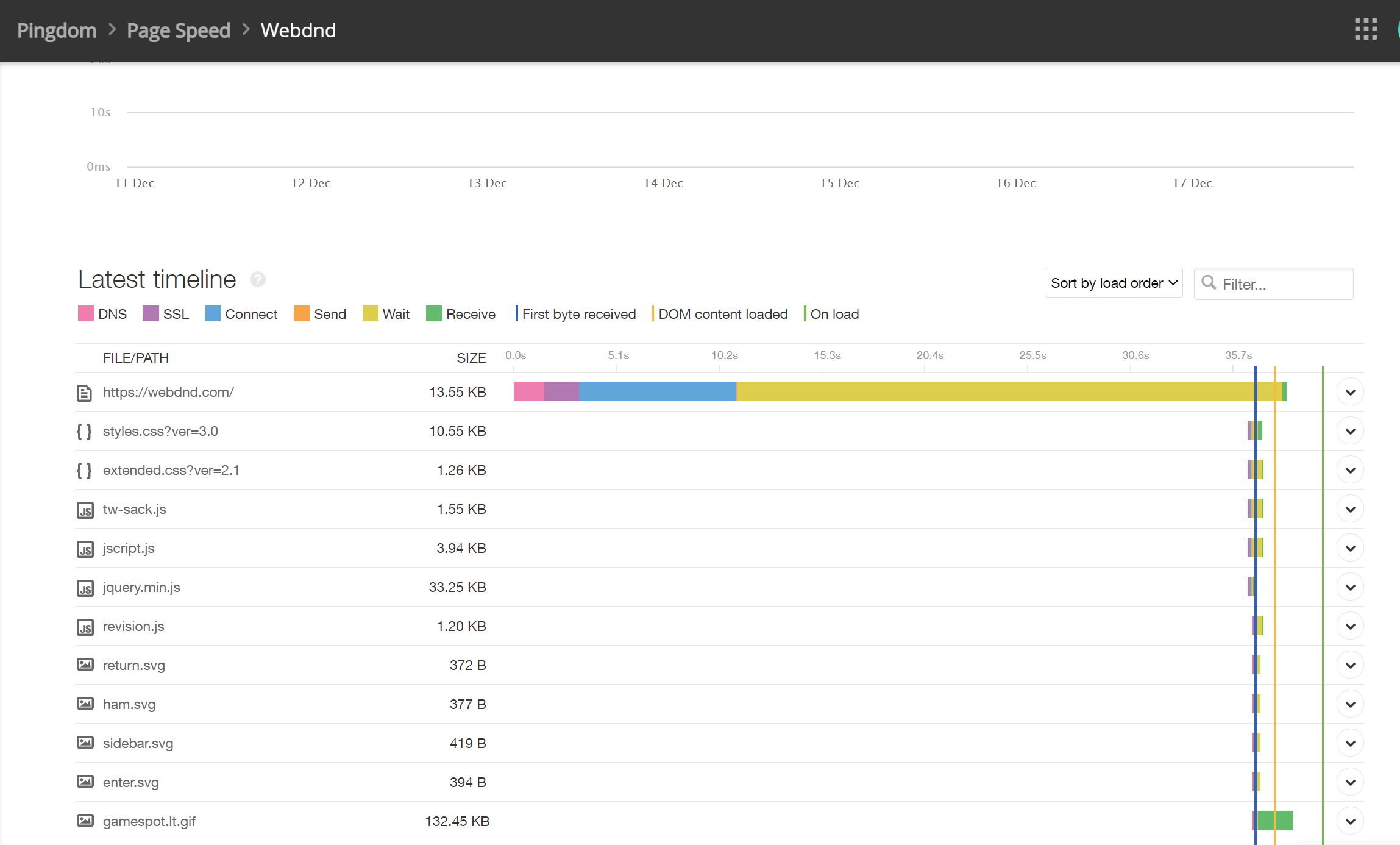

We have a website in our hosting. That became super slow. 30 seconds of PHP waiting for something.
It becomes great for guest sometimes. And for some logged-in users it is terrible.
We have (for given website in server):

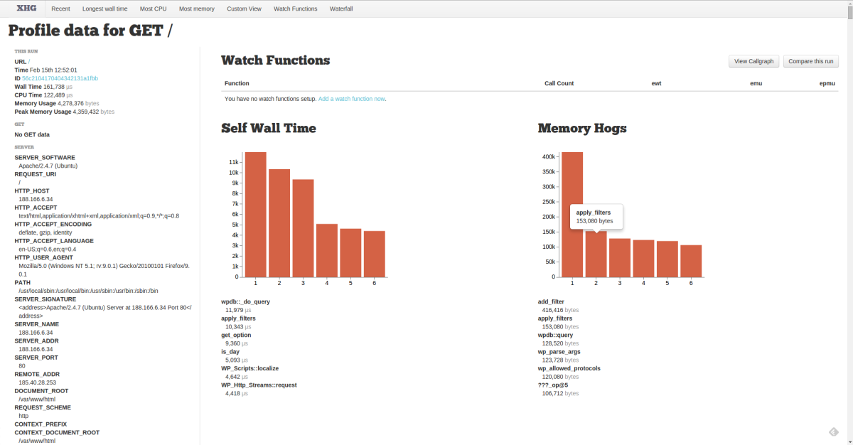

If you want to use some improved open-source UIs take a look at the following projects:
XHGui​
A graphical interface for XHProf profiling data that can store the results in MongoDB or PDO database.
Application is profiled and the profiling data is transferred to XHGui, which takes that information, saves it in MongoDB (or PDO database), and provides a convenient GUI for working with it.

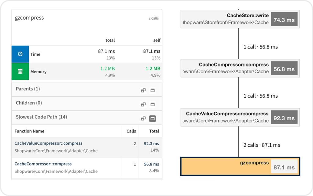

I'm considering to install Blackfire.io - that looks easiest to run as a SaaS and it has Chrome extension.
But I'm not sure how this would work with DirectAdmin - will it work, and will Chrome extension will help me to debug that even if I cannot load the page at all with my user:
Also will it be easy to uninstall and will it slow down server.
