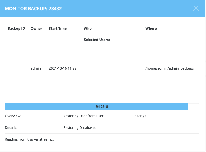

I have already said what happens:
It hangs during a couple of minutes on "Ensuring stored domains are present" and then it hangs a couple of minutes on "Restoring Databases" (even if the backup doesn't have any databases), then it hangs on "Extracting ~/imap directory".
When it hangs, nothing happens on the console. This happens with every backup, doesn't matter if it's 5MB or 2GB. This is the reason why a 5MB backup takes around 5 to be restored completely.
This only happens when restoring the backup, backup generation works as usual.

strange, enough memory? maybe it uses some /tmp partition? maybe CSF process tracking kills it?
unpack this archive from console tar xzf archivename.tar.gz works without errors?
Unpacking the backup from the command line happens in seconds.
CSF is disabled and there is plenty of ram/cpu available. When it halts resource consumption goes to 0.
