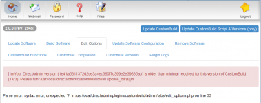

Hi All,
My server alert License check failure, Reason: license is expired.
I updated my server but after updating the custombuild command did not work.
Custombuild 2.0.0 (rev: 2945)
DA: 1.646
OS: CentOS 7.9
[[email protected] custombuild]# ./build versions
./build: line 1516: [: 1e41a5311372d2ce3a4ec360f7c399e2e39635ab: integer expression expected
./build: line 1521: [: 1e41a5311372d2ce3a4ec360f7c399e2e39635ab: integer expression expected
./build: line 1529: [: 1e41a5311372d2ce3a4ec360f7c399e2e39635ab: integer expression expected
./build: line 1534: [: 1e41a5311372d2ce3a4ec360f7c399e2e39635ab: integer expression expected
Your DirectAdmin version (1e41a5311372d2ce3a4ec360f7c399e2e39635ab) is older than minimal required for this version of CustomBuild (1.63). Please run '/usr/local/directadmin/custombuild/build update_da'
Does anyone help me? Sorry, my english is not good.

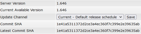

That update command is not valid anymore. What you are doing now is downgrading CB to a very old version. CB is now bundled with DA. You have the latest version of DA installed and with this also the latest version of CB.
I think (not sure) that you need to reinstall DA;
So that you also have the latest version of CB.

I see an error about options.php line 33, couldn't that be the issue? Maybe only plugin has issue again.
@ViT Try updating via my command via SSH, probably that will work for you.

I meant that first command in post #3 to download the CB script from files1. From what i see the latest version on those servers is 2945 with a creation date from a few months ago
Even the script on files.directadmin (new main mirror) is outdated
