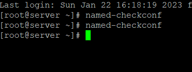

Try using this command and see if there are errors:
named-checkconf
The named-checkconf , didn't show something

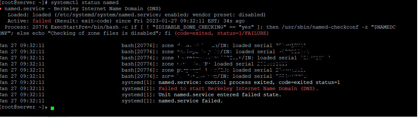

Also try to restart named, and see if it throws errors and which errors:
service named restart
Oke there you go.
You masked them. But in the output you see that 3 domains do not have any A or AAA records. Most likely that is the cause.
See if those domains still exist, if yes, check their DNS and update as needed.
If not, remove them from DNS.
Also check if you have SELinux enabled, seems there is some authentication issue, might be caused by SELinux.
