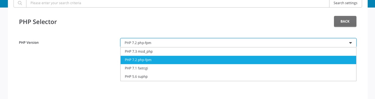

I compiled 4 versions of PHP but i can't select all in DA panel (i see only php1_release and php2_release). How can i select higher php_release for specified domain (can be in /usr/local/directadmin/data/users/username/domains/domainename.conf).
Now i see for example
php1_select=2
php2_select=0
When i tried change php1_select for 3 or 4 nothings change.
php1_select=2
php2_select=0
As said in my post above, DA pre-release or higher version than 1.55 is needed. No custom skin should be used (unless it's supported there). And there should be only 1 dropdown seen, not 2, in latest version of DA. If you see selection for first and second version of PHP, it likely means you're using old version of DA :) I hope that answers your questions, if not - let me know.
/usr/local/directadmin/directadmin v
Version: DirectAdmin v.1.55.0
It's too old? Maybe i have some old stuff in user config files?
