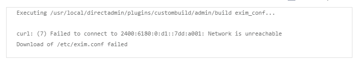

I am trying to update Directadmin and it show that network is unreachable
it looks like it is trying to connect IPV6 address. Does anyone know how to fix this problem?

Does this work?
./build set_fastest
./build update
if not
what is
grep downloadserver /usr/local/directadmin/custombuild/options.conf

I'm seeing this same issue, anyone know what the resolution was? We currently don't use IPV6 and it seems that custom build is trying to use it, when it's not available.

./build update
You get anything with this?
What the OS
and DA version
./build update
What the OS
and DA version
No downloadserver set in options no.
CentOS Linux release 7.9.2009 (Core)
DirectAdmin v.1.650
Thank you
After digging, it looks like it's a network issue, and not related to DA in this case.
As a follow up, in this case the DC had portions of hetzner.com IP ranges blocked for abuse, as they are a huge issue for bad guys, it was also blocking part of the good guys hosted there too, in this case archive.apache.org and php downloads.
