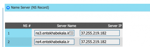

Hi
MY namservers aren't working. I configured the domains NameServers to the IP address of the server DirectAdmin has the IP of but its just not working
This domain is entekhabekala.ir
You need to add the IP's to the (nsX.) nameservers at your domain registrar eg. normally called child nameservers
The records at your registrar seem to work, that part is fine. It looks like a local problem.
Port 53 is open and reachable.
Check this:
At this moment I don't know why it's giving this failure. Port 53 is reachable. Try this.

Anyway, it's not really good to only use 1 ip for nameservers. It's best to use 2 different ip's and even like should be, on different servers or vps systems.

I think isp tried to configured NAT-based network for VPS or bridged-network to give a real IP and it failed.
