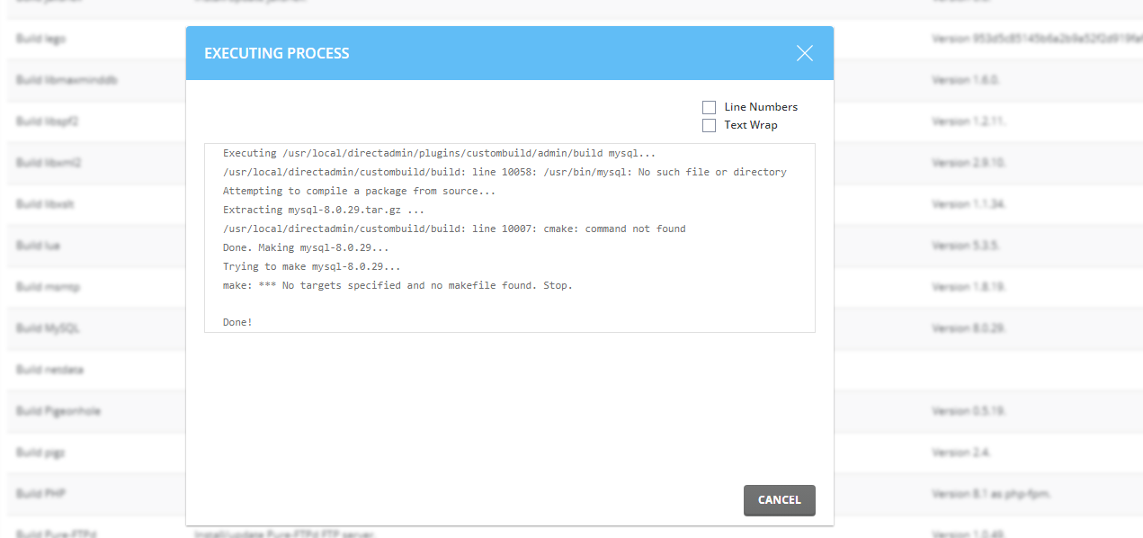

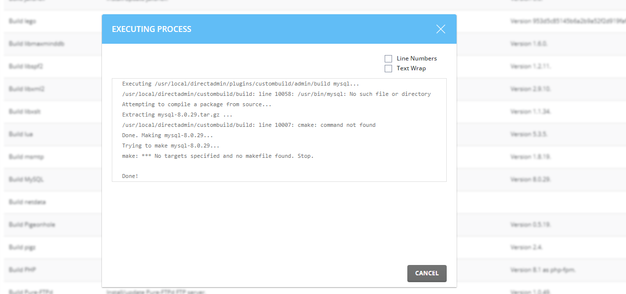

CustomBuild 2.0 comes with the following output when I try to build mysql
For those who might face the same issue. From the screen can I see the error: "cmake: command not found". Thus I suppose that's the core issue, and in order to solve the issue the "cmake" should be installed. For this one should run:
dnf install -y cmake
in a bash console as root, and then try the MySQL installation once again.
