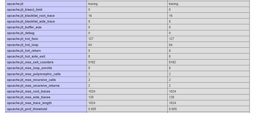

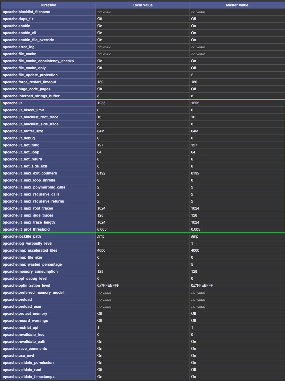

I think yes, but on phpinfo(), opcache.jit is not a key, and server show values for opeache.jit enabled
Best regards

To turn it off, you're only interested in the following directives:
opcache.jit
opcache.jit_buffer_size

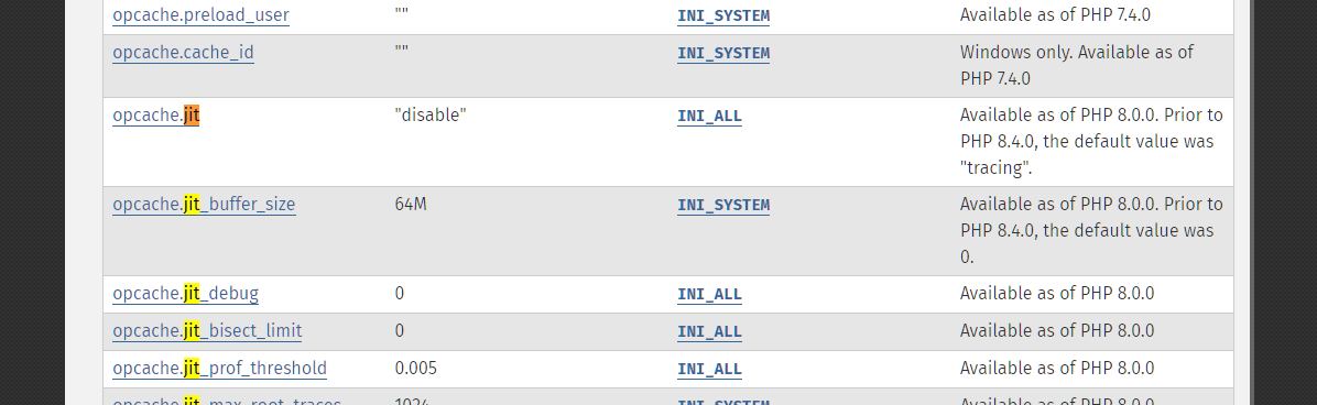

Depending on your php version, opcache.jit should be 'disable' to turn it off, it may show "tracing" after in phpinfo() but that's the default value I believe. It shows as tracing on mine (I'm using 8.3xx and jit is off):
Set opcache.jit_buffer_size = 0 and that should turn it off. You'll still see all the other bits again on phpinfo() but it should be off.
Hope this is of some use?
Refer to the PHP maunual here for this: https://www.php.net/manual/en/opcache.configuration.php

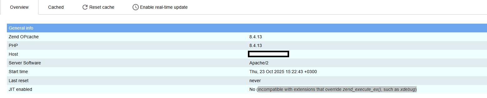

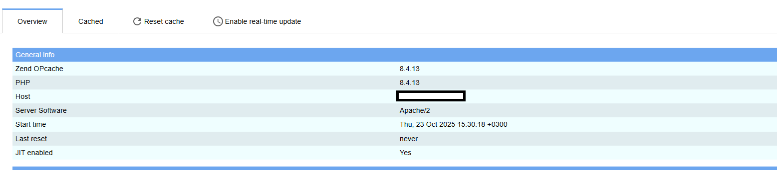

if you are enabled ioncube opcache.jit will not work
you will get warning
incompatible with extensions that override zend_execute_ex(), such as xdebug
and opcache.jit = disabled
ioncube enabled
Ioncube disabled
