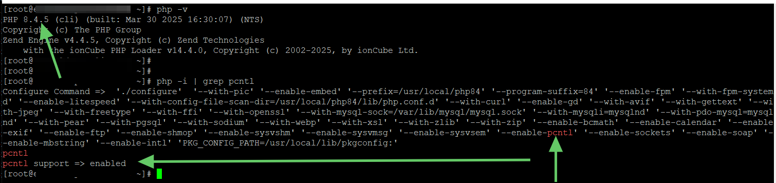

It should work. I've got it working on AlmaLinux release 8.10. How do you check its working on your end?
Bash:
[root@server1 ~]# php -v
PHP 8.4.5 (cli) (built: Apr 14 2025 10:39:21) (NTS)
Copyright (c) The PHP Group
Zend Engine v4.4.5, Copyright (c) Zend Technologies
    with Zend OPcache v8.4.5, Copyright (c), by Zend Technologies
[root@server1 ~]# php -i | grep pcntl
[root@server1 ~]# php -i | grep configure
Configure Command =>  './configure'  '--with-pic' '--enable-embed' '--prefix=/usr/local/php84' '--enable-fpm' '--with-fpm-systemd' '--enable-litespeed' '--with-config-file-scan-dir=/usr/local/php84/lib/php.conf.d' '--with-curl' '--enable-gd' '--with-gettext' '--with-jpeg' '--with-freetype' '--with-ffi' '--with-openssl' '--with-mysql-sock=/var/lib/mysql/mysql.sock' '--with-mysqli=mysqlnd' '--with-pdo-mysql=mysqlnd' '--with-pear' '--with-sodium' '--with-webp' '--with-xsl' '--with-zlib' '--with-zip' '--enable-bcmath' '--enable-calendar' '--enable-exif' '--enable-ftp' '--enable-shmop' '--enable-sysvshm' '--enable-sysvmsg' '--enable-sysvsem' '--enable-sockets' '--enable-soap' '--enable-mbstring' '--enable-intl' 'PKG_CONFIG_PATH=/usr/local/lib/pkgconfig:'

the PHP version did not upgrade:
Bash:
-rwxr-xr-x 1 root root 27297280 Mar 16 08:29 lsphp
lrwxrwxrwx 1 root root       26 Apr 24 08:31 lsphp84 -> /usr/local/php84/bin/lsphp
-rwxr-xr-x 1 root root      847 Jan 28 13:11 pear
-rwxr-xr-x 1 root root      868 Jan 28 13:11 peardev
-rwxr-xr-x 1 root root      781 Jan 28 13:11 pecl
lrwxrwxrwx 1 root root        9 Mar 16 08:29 phar -> phar.phar
lrwxrwxrwx 1 root root       11 Apr 24 08:31 phar84 -> phar84.phar
-rwxr-xr-x 1 root root    15253 Apr 24 08:31 phar84.phar
-rwxr-xr-x 1 root root    15251 Mar 16 08:29 phar.phar
-rwxr-xr-x 1 root root 27294872 Mar 16 08:29 php
lrwxrwxrwx 1 root root       24 Apr 24 08:31 php84 -> /usr/local/php84/bin/php
-rwxr-xr-x 1 root root 27294536 Mar 16 08:29 php-cgi
lrwxrwxrwx 1 root root       28 Apr 24 08:31 php-cgi84 -> /usr/local/php84/bin/php-cgi
-rwxr-xr-x 1 root root     3649 Mar 16 08:29 php-config
lrwxrwxrwx 1 root root       31 Apr 24 08:31 php-config84 -> /usr/local/php84/bin/php-config
-rwxr-xr-x 1 root root 27294536 Mar 16 08:29 phpdbg
-rwxr-xr-x 1 root root 27294536 Apr 24 08:31 phpdbg84
-rwxr-xr-x 1 root root     4879 Mar 16 08:29 phpize
lrwxrwxrwx 1 root root       27 Apr 24 08:31 phpize84 -> /usr/local/php84/bin/phpize
and the version remained the same:
Bash:
PHP 8.4.5 (cli) (built: Mar 16 2025 08:29:04) (NTS)
    with the ionCube PHP Loader v14.4.0, Copyright (c) 2002-2025, by ionCube Ltd.
    with Zend OPcache v8.4.6, Copyright (c), by Zend Technologies
See: the Zend OPcache v8.4.6 - UPGRADED, but PHP version never upgraded.
Fixed by renaming
Bash:
mv /usr/local/php84 /usr/local/php84.OLD
and re-installing PHP 8.4
Once PHP 8.4.6 gets installed, it can be recompiled and updated by usual means. I mean that, the commands:
Bash:
da build php 8.4
# ... some time later ...
da build php 8.4
the second attempt will update PHP without an issue.
Probably @fln could advise
@zEitEr, would be great to have access to this server to investigate this further.
We rely on PHP make install command to replace the binaries. If there are circumstances when the binaries would not be replaced it would be good to track it down and fix it. Our long term goal is to make PHP to completely replace whole /usr/local/php{nn} directory, but we have not reached it yet. Right now new PHP files are being merged over the old ones.
The PHP version was already upgraded, so I can not say whether or not it can be replicated. I will update the thread or a ticket if it can be reproduced.
I understand this is an old thread or post, but I recently encountered a similar issue and couldn’t find a solution. After exhausting all possible solutions, I discovered this method that worked for me.​
[Guide] How to Enable pcntl in PHP 8.4 with DirectAdmin CustomBuild​
If you’re struggling to enable pcntl for PHP 8.4 with DirectAdmin, even after setting php_pcntl=yes in /usr/local/directadmin/custombuild/options.conf, this guide is for you! I spent a while troubleshooting, so here’s the solution that finally worked for me:
Step 1: Edit the PHP 8.4 Configure Script​
Open the configure script for PHP 8.4 in your editor:
nano /usr/local/directadmin/custombuild/configure/php/configure.php84
Step 2: Add --enable-pcntl to the Configure Options​
Scroll to the end of the file and add the following on its own line:
--enable-pcntl
Step 3: Save and Exit​
Press CTRL + X
Then press Y to confirm
Hit Enter to save and exit
Step 4: Rebuild PHP 8.4​
Navigate to your custombuild directory and rebuild PHP:
./build php 8.4
Note: This process may take a few minutes.
Step 5: Restart PHP-FPM
Once the build is complete, restart the PHP-FPM service:
service php-fpm84 restart
Step 6: Verify pcntl is Enabled​
Check if pcntl is enabled by running:
php -m | grep pcntl
If everything worked, you should see:
You now have pcntl enabled in PHP 8.4 on your DirectAdmin server. ;)
