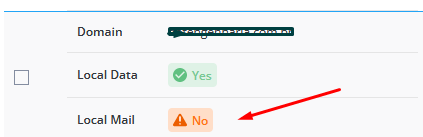

Good evening everyone, I have the following problem: 1-I have only one domain that the customer complains about the message above in the title when replying to any email received in his mailbox. This client normally sends any message if it creates in roundcube, it receives all messages without problems. When he selects a message received with or without attachments, he cannot respond because the Connection Error message appears (Failed to communicate with the server) only for his domain account, the other accounts are all ok. Note I checked the following: In dns administration appears his domain as: local date =yes local mail =no I added his domain in the /etc/virtual/domains file gone local error mail =no and changed to yes But it didn't work can anyone help.

To begin with, don't try to change physical files first. Always first try via the panel.
Go the the customers account, login as the customer and then go to his MX records option.
Then check if
Use this server to handle my e-mails. If not, change the MX records and uncheck this option.
be sure this option IS checked.
Thankyou error persist

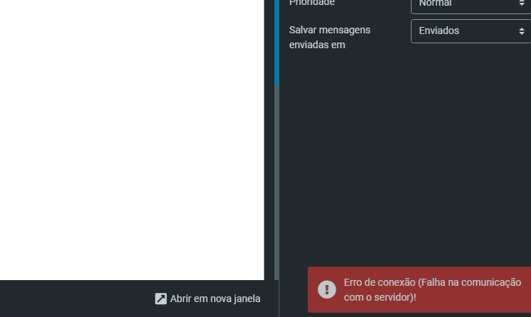

Connection Error (Failed to communicate with the server) ROUNDCUBE​

I have some clients with the same problem.
Connection Error (Failed to communicate with the server)!
When they reported the problem, I thought it was a connection problem (ISP)
Today I saw the problem.
The problem occurred while replying to an email with an attachment.
When clicking the "send" button, a connection error message is displayed immediately.
I looked for error logs at:
/var/www/html/roundcube/logs
And there is no error log on this error specifically
I tried setting permissions, but to no avail either.
I did a rebuild on roundcube and directadmin, but without success either.
EDIT:
Modsecurity = rule 212880
Just disable this rule in waf that will solve the problem
