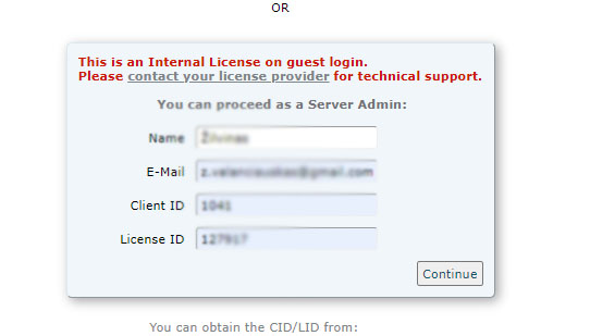

Yup, I'm bit in the trap right now, because I have bought this VPS server from reseller, and they are not able to help me. I have tried write to DA support, but I need direct license of DA to open a ticket (I have only server reseller's DirectAdmin license). So probably there is no way out... :(error.jpg

Yup, I'm bit in the trap right now, because I have bought this VPS server from reseller, and they are not able to help me. I have tried write to DA support, but I need direct license of DA to open a ticket (I have only server reseller's DirectAdmin license). So probably there is no way out... :(View attachment 3722
They can open a ticket for you if they cannot solve the problem.
