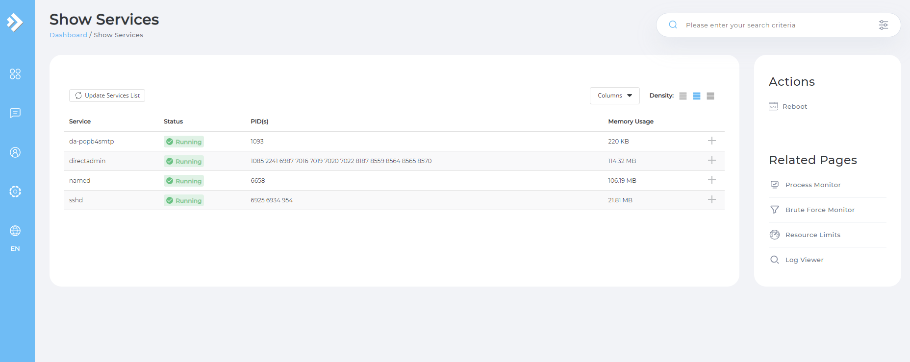

After we updated the server of one of our customers to DirectAdmin 1.63.2, some problems started to occur, apparently maintenance tasks stopped running, like night tally. We checked /var/log/directadmin/errortaskq.log, which was full of this error:
[fatal] directadmin service is not running, refusing to run error=unable to get license info: Get "http://unix/license": dial unix /usr/local/directadmin/da-internal.sock: connect: no such file or directory
DirectAdmin, however, was fully accessible to clients on port 2222.
The problem was fixed by simply restarting DirectAdmin (service directadmin restart).
Maybe there is a bug in the update script, and the DirectAdmin status system itself was not able to detect it, as part of DirectAdmin was running ok.
@unihostbrasil, I think the issue was caused by directadmin service not being restarted after upgrade. Because upgrade was done successfully cron was running latest version of dataskq, while directadmin without a restart was running older version.
The issue should not occur anymore since latest directadmin takes care of providing required functionality for dataskq.
We will double check the upgrade scripts. Could you please give us DA version from which you upgraded to DA 1.62.3?

Hmm something does not add up yet. directadmin service starting version 1.62.8 always creates da-internal.sock file on start. This file also removed when directadmin service is stopped.
Even older DA should have provided the required services for dataskq.
Error messages hints us that the file was absent in the system. So I think there could have been three scenarios:
  • directadmin service was not running (and removed da-internal.sock on shutdown). Seems unlikely ? considering web panel was functioning at that time.
  • A new directadmin service started before old one terminated and old one on termination removed the da-internal.sock which was already owned by a new process. Will do some tests to check this hypothesis.
  • File da-internal.sock was removed by some external tools or actions. Sounds like a long shot.
@unihostbrasil, could you give us more details about the OS? Are services managed by systemd or rc scripts?
