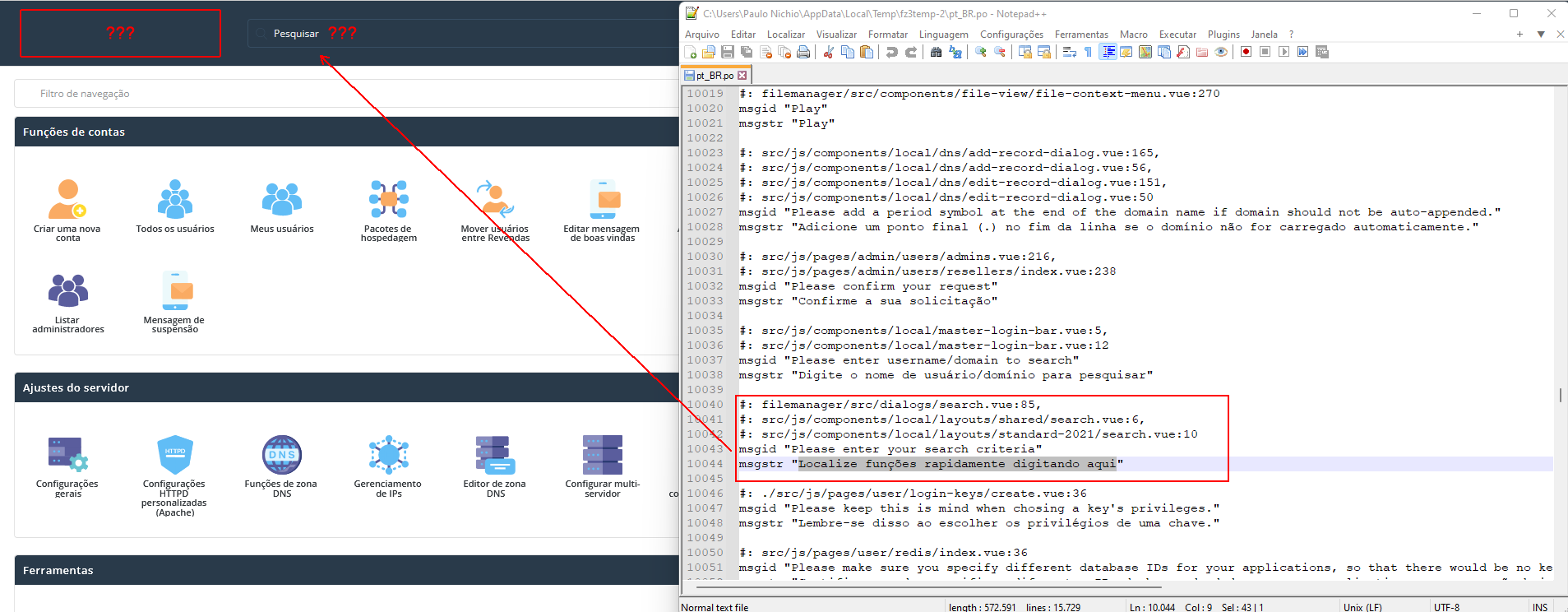

Has there been any change in the DirectAdmin translation?
I translated the pt_BR.po file and threw it in the folder
/usr/local/directadmin/data/skins/evolution/lang
Then I generated a Json and threw it in the folder:
/usr/local/directadmin/data/skins/evolution/assets/translations/custom
And the language change does not occur, remaining the incomplete translation of the DirectAdmin translation system.
Another problem is that we put the CSS for the subtheme, but in Firefox, the logo doesn't appear. Chrome, Safari and other browsers display normally.
Another problem is that by default we use Portuguese (BR) as the default language on the server. Since the last version, when logging into the system in a browser without cache, the English language is loaded by default, and every time we need to go and change it to pt_BR.
Thanks for helping me with these issues. ;)

@paulonichio there is no need to convert translations to JSON and move to custom directory, just keep your translations in .po format in /usr/local/directadmin/data/skins/evolution/lang and set language_list in directadmin.conf:
$ da config-set language_list en:pt_BR --restart
language_list=en:pt_BR
Setting language_list to a non empty turns Evolution into backwards compatible mode and it uses .po files from /usr/local/directadmin/data/skins/evolution/lang. When this flag is empty Evolution uses languages that comes built-in. Dealing with JSON files was a temporary workaround until we implemented backwards-compatibility mode.

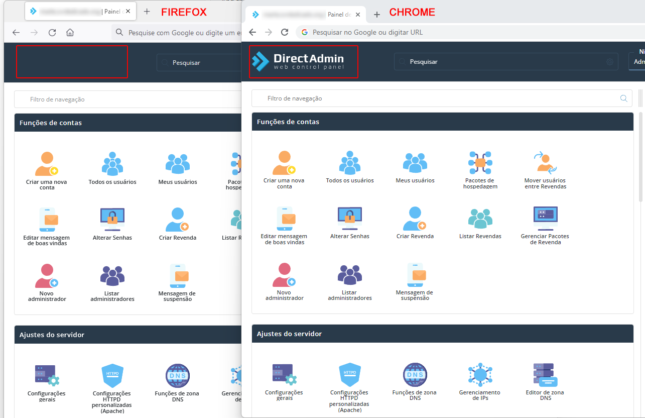

DirectAdmin logo issue in Firefox using subtheme CSS not showing, can anything be done to fix the issue?
Clear cache not resolve the problem for example.
About the problem in the translation, by inserting "language_list=" apparently fixed the problem.
