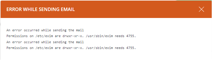

Resend welcome e-mail doesn't work since the latest update....
fix_permissions didn't solve anything.
Looks like my issue was something different and had to do with rspamd which prevented /usr/sbin/exim to be linked with /usr/sbin/sendmail;Exim configuration error in line 590 of /etc/exim.conf: failed to open included configuration file /etc/exim.clamav.conf
Hello, today I noticed that I have several frozen emails in the mail queue, but if click on "Retry" button to send again, it return this message: 2022-08-07 12:43:36 Exim configuration error in line 590 of /etc/exim.conf: failed to open included configuration file /etc/exim.clamav.conf I...forum.directadmin.com
$ ls -la usr/sbin/sendmail
lrwxrwxrwx 1 root root 9 sie 7 06:47 usr/sbin/sendmail -> /etc/exim
2022-08-07 06:47:26 localhost: called: cron
2022-08-07 06:47:32 localhost: DirectAdmin update requested
