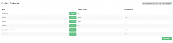

No idea what just happened, but even though my domain is set to PHP 8.1, it's using PHP 8.2. This was working fine until the recent release. I wouldn't care about it being 8.2 for all the other sites, but some of them use IonCube Loader.
Really odd stuff showing in DA updates too:
Pay attention to the PHP 8.1.. it has 8.2 updated over the top of it and it's saying there's a new version available.. which is 8.1.. something seriously messed up.
What needs to be done to fix this? This has taken down a lot of my sites.

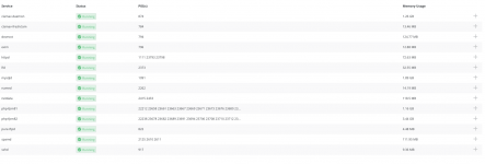

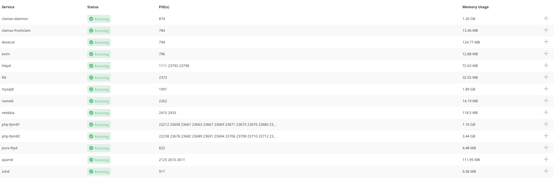

PHP 8.1 service is definitely running.
I tried changing to 8.2 and then to 8.1 to try fix it, didn't work.
I have exactly the same error mentioned earlier here.
Yep, I can't do anything. I've tried even removing PHP 8.1 entirely, rebuilding , rebooting.. re-enabling and the issue just comes back. I have 13 clients who are impacted by this and I will almost certainly have to give service credits.

thanks @alrnetwork, for allowing us to check the issue out on your server. We have resolved the issue. Root cause was customized PHP 8.2 configure script, which forced installing PHP 8.2 files into PHP 8.1 directory. So each time PHP 8.2 was updated it would mess-up PHP 8.1 installation.
@djcart if you have similar issue, please check if you are using customized PHP configure scripts. We recommend using default configure scripts bundled with DA.
