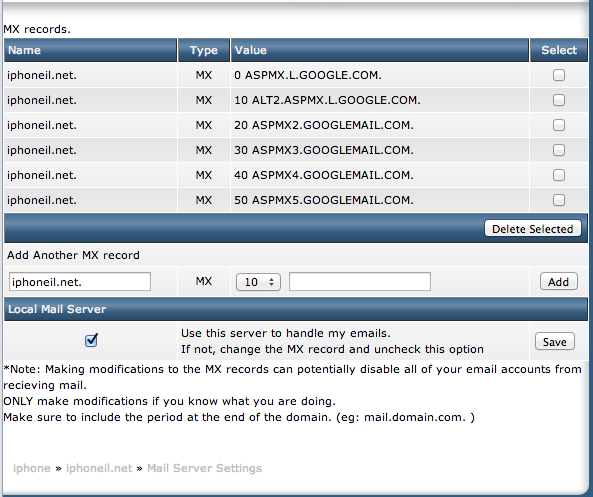

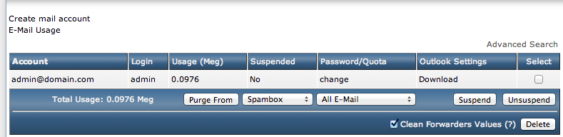

I am attaching some pictures that show the options that I have in settings.
The first picture actually shows the settings of directadmin under »User Level
The second picture shows the information of the domain (one domain) is stored on the server

I don't think the name of your domain is domain.com (I know who owns that domain; they paid a lot of money for it, and they don't run DirectAdmin). Please see this page (homepage.ntlworld.com) for good reasons why you shouldn't obscure your DNS data when asking for help.
But note carefully the checkbox is not checked. This means DirectAdmin isn't attempting delivery on your server, but rather for an mx record for domain.com. Since domain.com isn't hosted on your server, if your DNS is set properly it's attempting to deliver the email to a server at domain.com, and if they have an email address the same as you're they're getting the email. If not, the email is being bounced back to your server, check your exim queue.
So why do not Send Mail? Even from the server and stored on the server accounts?
The second image you've attached shows that email for iphoneil.net is hosted at a Google ac****, but because you do have the checkbox checked any email originating on the server is delivered not to Google, but to your local mail, which you're likely not checking, and you may not even have a mailbox set up for that email address on your server.

Go back to post #5 above, the first link. Look way down at the bottom left of the screen image. You'll see that domain.com exists on your server.
How did you get to that screen if it's not somewhere in your control panel?
To find it, do an admin level login to DirectAdmin and in the search box at the top enter domain.com and click on the Domain button.
