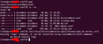

Hi Richard;
I do the process again of your https://forum.directadmin.com/threa...e-your-servers-hostname-in-directadmin.70371/
I deleted all the files, but when I try to generate a new cert the software returns the same Lego error
After delete cert files, directadmin can't start because the https validation.
It's so strange

Yes that is very strange.
Can you issue this command:
whereis lego
it should give the result like:
lego: /usr/local/bin/lego
if that is the case, you can best send in a ticket because something doesn't work as should be then.
Try cd /usr/local/directadmin/scripts/ then the ./letsencrypt.sh command.
whereis lego
The directory of the tool is in the corred path
The same error.

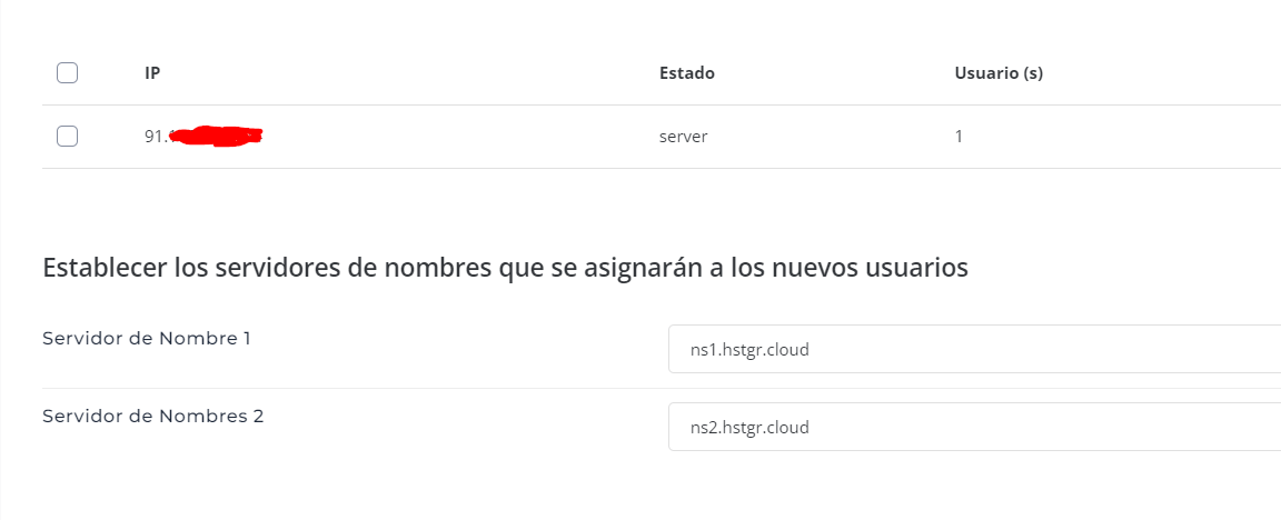

hola floyd,
I configured the servernames like Richard said me (attached)
why I can't ping the hostname from other machine.
From any other machine or only your pc at home? Because if it works from another server, then there is nothing wrong.
If you can't ping it from any machine, then something is wrong with either DNS or nameserver.
You can best post the correct hostname so we can investigate or give it to me by pm if you don't want to post it in public.
The nameservers ns1 and ns2.hstgr.cloud are not registered with your hstgr.cloud domain name registrar.
That doesn't really matter if you use the hostinger DNS. But you didn't copy your A records to the hostinger DNS and not your MX records.
Without those A records, your domain can not be found.
So if you want to use your domain, you have to copy all your records, so A, TXT, MX and DKIM records to your DNS from hostinger for things to work.

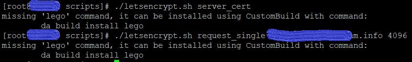

I also experience the same. @LaqueP
I need to update the SSL certificates for the directadmin Services, I try using the .Letsencrypt.sh script, but it return a Lego error:
./letsencrypt.sh request_single server-xx-xxx-xx-xxx.da.direct 4096
missing 'lego' command, it can be installed using CustomBuild with command:
da build install lego
/usr/local/directadmin/scripts/letsencrypt.sh server_cert
Lego is installed and all the domains auto-renew is working correctly.
I need the SSL for directadmin services to connect third party services.
Anyone know how to solve it?
